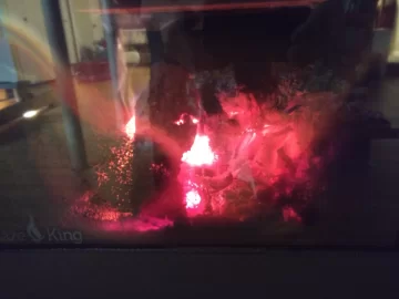

You are saying you can burn overnight with visible flames the whole time? I know I can't either the princess I am using. If I go to bed with it set to be running with active flames there will be pretty much glowing charcoal in the morning. Maybe an occasional wispy flame but far from what I would call active flames
This was this morning at 11 am after last night's 9.20 pm or so reload.
Rereading your post, I call this flames, you may call this whispy flames. It's a bit hard to see, but there are multiple 6" tall flames, blueish, on the left. We may be consistent after all?
