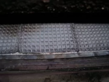

Someone at Woodstock told me mix the pine with harwood if you can, Pine can burn dirty and clog the cat quicker than hardwoods. I have some bone dry Pine I plan on burning first this year, we'll see what happens.
This is what dry pine does to a CAT in three yrs.

I read Todd's post and just knew N of 60 would post the pic.
Is that a good thing or a bad thing? Am I that predictable? :cheese:
