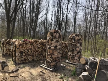

I use to uglies for camp fires, I saw someone make a bin from an old corncob silo, so that got my wheels turning, I bought a role of 72" welded wire fencing, cut 10ft section and made cylinders that stand up on pallets, then I throw the uglies in a random lay into the cylinder and let them season for a full year (they dry pretty quick due to the random lay and having good airflow vs a tighter stacked wood pile) I then burn the chunks during our shoulder seasons, works very well for me and I have 5 cylinders full and ready to go for this year.
