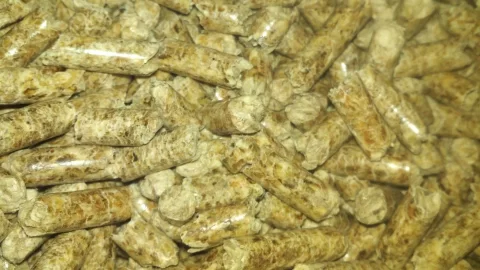

Out of curiosity, can you post a pic of the pellets you are burning? Have you been burning the same pellets since you bought the stove?

here is the pellet

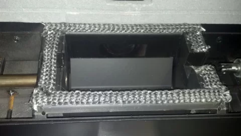

Here is my CPM with a 5/8" Flat Meeco's Red Devil Gasket. Seated with High temp silicone.

here is the pellet
Im sorry, I meant a picture of the bag. I can tell you that if you are not getting an accumulation of ash around where the burnpot sits on the cradle, you more than likely have air bypassing the burnpot.

I just wanted to make sure you werent burning old stock of maine woods pellets or something....

By the time the pot "Seats" itself in the gasket, its about a 1/16" or 1/8" max above where it is now. And i had no ill effects with my CPM and ignitor alignment (the CPM has an Air pump connected to the ignitor to help light ALL fuels).
Not "round" or regular gasket.
It must be a flat/tape type gasket.
