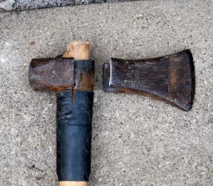

This is a good example of 15 years and 15 minutes. I bought the wooden one in the middle 90's, but it only got a workout in the last five years. Made out the logo "Black Knight". I bought the red one "True Temper Total Control" a few years ago and the handle cracked in the first 15 minutes, no doubt an over-strike, but only one. I put it away. When the wooden one came apart a day ago, I got the red one out and finished it off with a few more whacks.

I'll ask the folks at House Handle Company to see if they have a handle for the red one. I always assumed a maul head was too simple to break!!

I've never seen a maul head break like that. You must have the power of a grizzly bear or something.

Looks like you found the weak spot. Cast is tough, but it ain't strong. There is little to no flex in cast. Too tight of a wedge pushing outwards combined with repeated metal to metal contact killed the little dude. It happens. (by that, I am not suggesting you did anything wrong, its just the nature of the beast and probably a weak design).
That maul head is thinner around the handle than my old style maul is.

You could probably put the old one back together too. Might be worth it if it's cast steel; if it's cast iron it's a much longer project with worse chance of success, and I wouldn't even mess with it.

I'd like to put a new handle on the blade from the red one so there's some kind of spare. Sometimes it's perfectly fine to pick up a tool that's 50 yards closer than the one you'd rather have!

I think the broken maul head is going to find its way into the recycle bin...

I have gotten a few things done. I got the remaining maul head on a new handle, and that was a story unto itself.

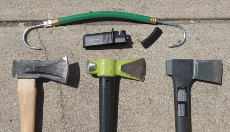

I put an edge of sorts on the BASH. I used the Fiskars sharpener to go over the X27 to make sure it had an edge. BTW, the sharpener actually works. I took the BASH and X27 down to the oak pile. Selected a really nice 1/2 round as a target. X27, swing, boom, two pieces. Same thing with the BASH, and Boom, two pieces! Did a few more swings on various bits and both tools are quite good.
Walked the BASH back up the hill and saw an oak 1/4 burl my electric couldn't split. Put it out in the yard and lined a up a shot. POW!! I've had to dig wedges, chainsaws and axes out of splits before, but I had to dig the BASH out of MY YARD!! HAH!

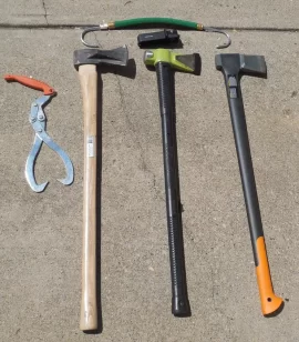

At my age I'm not gonna' hand-split no way, no how, but these are very good tools. The BASH seems heavy to me, but that could change by the end of the summer. Here's a photo.

I had a unit similar to the broken maul in the OP, but I kept breaking wooden handles overstriking them.
I went down to the local steel yard and got a short section of 2" and a long section of 1 1/4" pipe. Heated and ovaled the 2" pipe to fit inside the eye, slid the smaller pipe inside the larger and welded the ever loving @$#(% out of it.
It won't be breaking any time soon now.==c
