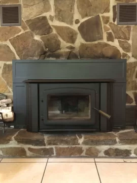

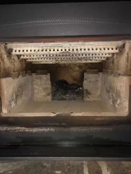

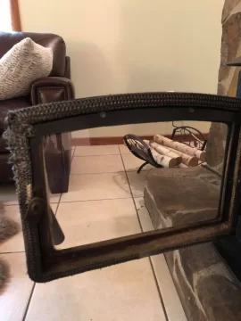

The owner wants to switch over to a coal furnace so he says. These are some photos of the actual stove. He did say the door may need a new gasket even though it was sealing properly late spring when he used it.[Hearth.com] Buying a Enviro Kodiak 1700 insert this weekend. [Hearth.com] Buying a Enviro Kodiak 1700 insert this weekend. [Hearth.com] Buying a Enviro Kodiak 1700 insert this weekend. [Hearth.com] Buying a Enviro Kodiak 1700 insert this weekend. I need to call and see what they retail for here. Sent a couple emails earlier today.
That door gasket does look ratty which is surprising after just one season. It should be replaced with an OEM gasket from Enviro. Maybe offer 1700.
Offer $1500, I doubt they get more than that, anything above that I'd rather by new. That way you know it's in great shape and have a warranty.
I was going to start at 1500. Just not sure if I should drive the hour 45 minutes and do that in person or mention it over the internet. He did tell me one else has responded to the ad yet and it's been listed for 2 weeks.
Considering the long drive and the long time on the market $1500 may work. He can only say no.
Called a few places and they retail at 2500 around here near. I assume he will take less than asking since its been posted this long with no interest. so still seems like a good deal. He was very knowledgeable but I'm going to ask him to send a few more pictures. Where are areas to look for if there was any over burning going on?
From the pictures I don't see signs of overfiring. If it had been the paint would have started to grey and in some cases the baffle or tubes start to sag. The bricks look good too.

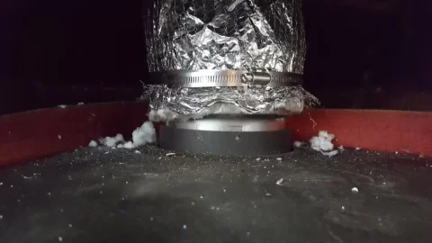

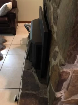

I have the insert almost completely installed. Having trouble getting the entire adapter into the stove. Is there any issue with leaving it as is and screwing it in? The rigid part of the adapter is below the screw holes. Here's a picture of it. [Hearth.com] Buying a Enviro Kodiak 1700 insert this weekend.
Could be fine. How far in is it past the screw hole?
Around 2 inches. From the inside of the stove it looks as if another half in could go down but I can't get it in for the life of me. Also should I wrap the entire area with insulation after installing the screws? The plan was to put safe and sound insulation on the sides, back, and top a couple feet up.
