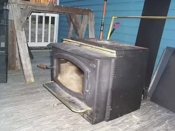

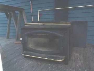

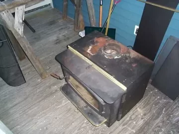

Attached are some photos I took yesterday. There are no pictures of the inside as I took them so my girlfriend could see what the stove would look like.
The secondary burn tubes are straight but the holes are recessed as if the tubes were dented inwards maybe 1/8" before or while the holes were formed. They look uniform and I seem to remember them being like that on the Lopi stoves I looked at so I think its normal.

Looks to be in decent shape. That rust on top is just surface rust right?
Yeah, it should come off with a wire brush. When repainted it might leave a little pitting but it shouldn't be too bad.
