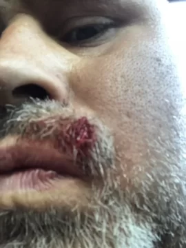

Wife, RN/Paramedic, was not happy the faceshield went away when she stitched me up from a plastic wedge that smacked me in the face.

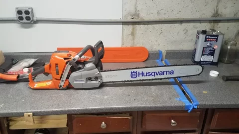

Got it tonight ya'll! Wisc Woody, I just did the exact same thing you were talking about regarding learning to start it when its warm. If its warm, don't touch the decompression button... Don't touch the button prime bulb right? Also don't open the choke... Just turn it to the run position. Either way. You can tell this sucker is gonna rip!

Nice saw! Well, if it’s fairly hot- like within a few minutes of running the saw I use the decompression button and just pull it and my saw will start right up but if it sits a bit and cools down some I decompress it, push the bulb once and I set the choke then back it off half way and it always starts. YMMV.... my saw is one of the first ones made and I think they’ve improved on them since. And the prime bulb isn’t a real primer, it just gets gas into the carb not the combustion chamber like a real primer-I think. Someone here might have a better explanation of what it does. You’ll like the saw- especially if you get it ported someday.

What bar length did you get, maybe a 24"?
It is indeed the 24... I think in the future, i'm going to get a 20" bar for it but get the new lightweight Husky bar that came out. Dealer said its pricey though...
I think i shouldnt have pressed the decompression button after running it for a very short while. I think that is what somewhat flooded it. To clear it I just kept pulling until that sucker started spitting some smoke... lol. Either way, will get used to it by using it. I plan on cutting Saturday. My buddies 590 is new and for some reason it bogs on throttle pull (not in a cut) You think he needs to richen it up a bit? I know they say they come really lean from Echo.
