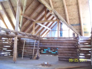

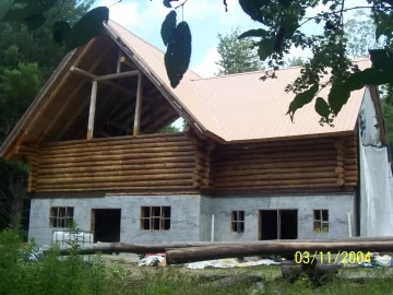

  • [Hearth.com] Buying new Hearthstone Mansfield instead of a used one
I think you have a good plan.
As for installing the fisher in the cabin, just make sure the insurance company is OK with it. Some are a little hesitant to allow the installation if the fisher is old enough that it does not have a UL tag.
Enjoy the new stove. They are beautiful units.

Beautiful cabin by the way. Looks kind of similar to our setup.
Thanks for the great comments on the loghome . Handcrafted over 10 yrs so far, windows go into the log walls this spring and split stone on the basement foundation . Stone chimney and electric service , soon.

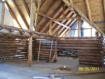

Ok, 2 stoves should do the trick. I highly recommend you pick up a flue thermometer (probe type if double wall) if you don't already have one. It helped me a lot with learning the stove. And post pictures! We like pictures.

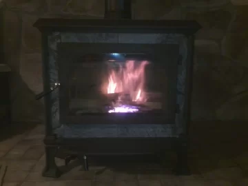

We put the Mansfield in our present house today , fired it up to 100F, cool down tonight then up to 200F tomorrow morning then cool down , then to 300F tomorrow evening . Going to be about 9F Christmas morning , can't wait.
Reactions: Dairyman
