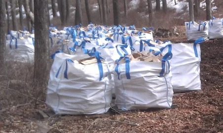

So im gonna be buying around 20 cords of wood so i can keep a good turn around supply every year. Looking around and a gentlemen is selling the wood in a 4x4x4.5 bag loaded on a pallet. Want to ask your opinions on if its a good idea to put wood in something like this, especially if it will be sitting in the bags for a long time. He also stated each bag is half a cord in one bag based on those dimension could he be right? What do you guys think? So roughly I will be ordering 40 bags. I have 3 cords of seasoned wood left from last year that will start me off for this year winter. He also states the moisture for this wood is around 15%.
Hmmm...the sight of 40 of those bags sitting around doesn't really appeal to me, but that is just personal pref.
4X4X4 is half a cord - stacked. Tossed in has less volume/value. By how much can be debatable.
How well do they breath? Do they let rain out effectively? Do you have the ability to move these around? These are questions I would want answered.

That looks like it is going to stack out a lot less than a half a cord.
Reactions: jaychino415
I would guess each bag is probably 1/3 of a cord. I would say the only way to know is to buy and then stack it out. Are they cut to the right length for your stove. It looks like a convenitent delivery method but i would want it in stacks not in bags, no airflow there. I had a loose thrown pile that had NO drying in the middle last year. My pile was 4 ft high and about 8 ft wide. First two layers were ok but below that it was wet and moldy............ i think you might have that heppen with these sacks.
Definitely a strange way to sell wood. I have never seen bags like that before. I would be concerned they hold rainwater or at the very least moisture. The only side that really needs to be covered (the top) is exposed. I think a smarter approach would be to stack the wood and put the bag on inverted. As this method wasn't chosen, I would think that is because the wood is not actually stacked, rather heaped into the bag. Also I would have to do a walk around, but as others have said I would find it hard to believe that is 1/2 cord. Just out of curiosity are you leaning towards this dealer because the bags are priced good?
Sorry for the wrong forum post. I had the same sense of 1/2 cord vs 1/3 cord. The appealing part is not having to stack 20 cords of wood and not having the mess of the debree of the wood when dropped off in my yard. But none of that matters if the wood is not gonna breathe and the volume is way off. The price he give is 150 for 2 bags deliverd to me as he is not far away. What can i do to help me insure breathability and volume is good?

Take one bag and stack it out (even if it is on his lot). Bring your tape measure and measure the volume. Now you know.

I would explain the volume concern and offer $100 for the two bags. That would probably be $150 per cord that way. Plus it's craigslist, it was made for haggling.

If you do this take a moisture meter with you and make a fresh split to measure, I would be flabbergasted if it was actually as low as 15%.

Those bags are no where near 4.5ft tall. I'd say they're more like 3 ft tall. If so, and they are truly 4x4' (which I also question), then they would contain 48 cu ft of wood or 3/8 of a cord. Still $100 for 3/4 a cord is not bad, especially if it is reasonably seasoned. In our area they would sell for twice that price. But wood locally is a rip-off market here.

A standard pallet is 40" x 48". If those bags are on standard pallets they are far less then 4' square and 4.5 high. Probably more like 3x3 bags bulged out a bit. I bet they are at most 1/4 cord and wouldn't be surprised if that was on the high side, it could take 5 of those bags to make an honest cord.

Im going to do a pre inspection and bring my Moisture meter with me. Ill bring a tape measure also. Do my negotiating when see I them. Thanks for the heads up! Gonna look up now how to tell the difference between wood species.

The State of Maine's law puts a loose-thrown cord at 180 cubic feet for splits 12-16" long. So, if the bags were actually 4x4x4.5 feet, magically retained their rectangular shape and were completely full, Maine law would call them 0.4-cord bags.
There's no way I'd store the wood in those bags long-term unless it was in a barn, and then only if I knew the wood to already be very dry.
My concerns are the same as everyone elses; not as much wood as he's promising, and not as dry either.
