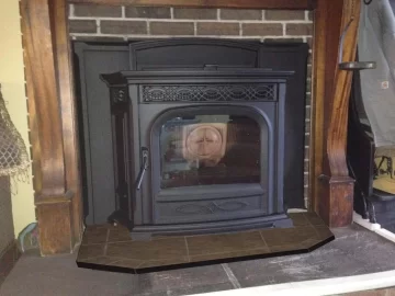

Not trying to be nasty,I only fix them,but I do know 99% of inspectors(insurance,state,local) are told the mfg install reccomendations are the final say.
The manual is the bible in this case. It represents the tested and UL approved method of installation. Fortunately both of these problems (visual and compliance) are easily solved by putting either a slab of stone, a layer of half-brick or a hearth pad under the unit.
trusting an installer is like trusting a hooker that she doesn't have an STDIf the installer didnt think it was a good idea/safe to put the stone on pieces of wood I am sure he wouldnt have done it. Again he has installed thousands of stoves
Absolutely. I had this stove installed recently. There is no way that stove should be sitting on combustible material. If there is a fire, your insurance won't cover the damage because they will see the stove was not installed according to the manufacturer specs. No way I would have let my installers leave the house with that stove installed like that. That's just me.
He's not going to pass it, not like that. If that is even a final install photo. It's mighty hard to believe anyone would leave the stove like that.If the inspector has a problem with it I am sure the installer will come out and correct the issue if it does not meet code
Side clearances and clearance to the mantel must be a foot. Tough to tell by this pic, but it does look like they didn't honor those clearances. Pretty scary. I would agree with Chickenman on pulling it and lowering it the current hearth as long as the side tolerances are good. Do some of these "installers" just look at the clearances as suggested and not required? I had to tear out my entire wood mantel surround when installing my 52i so that I could adhere to the clearance requirements.The OP asked nicely for visual examples of better support to show the in-laws. Can you supply any?

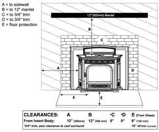

Here is a rough idea.
What are the side clearance requirements for the stove. Normally they are about 12". The mantel looks closer than that. Can't tell if the mantel over the stove is ok or not. Which model stove is this?
That is a 52i smokey.Woops,I mean Begreen!The OP asked nicely for visual examples of better support to show the in-laws. Can you supply any?

C'mon. No one in here wears underwear! Not when the stove is on!Ok everyone can calm the HELL down. I just spoke with my mother in law and the stove is sitting on two bricks NOT wood 2x4's !!
everyone untwist their panties please![]()
Not to be a jerk but, Damn! If I was putting that kind of cash into a stove and a living room center piece I would definitely not have it jacked up on bricks. That is just flat out Hill-Billy. Get a good fix and complete the install job. That is like having a nice new car sitting up on blocks in the front yard.
Don't misunderstand me here. I love my Harman also but I feel the installer took the Quick and Dirty in and out route. I'd want a discount on the install job or them to get it right. Sure bricks might work but it is JAKE as hell.
