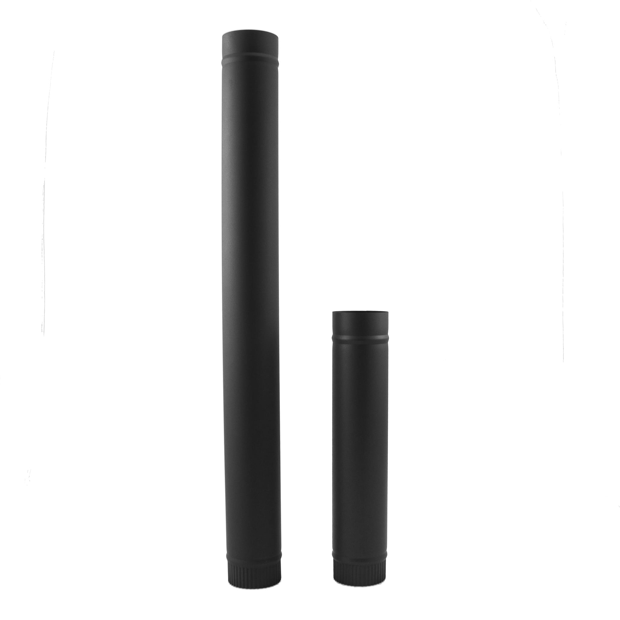

From your measurements of the oval, I'm wondering if 4" stovepipe would fit on there. Something like one of these

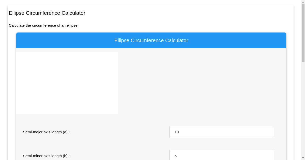

I used your measurements (4.75/2=2.375, 3/2=1.5) on this page and it looks like it would be close (12.48" vs. 12.56" circumference for 4" pipe)
Good luck with getting your caboose stove running!
