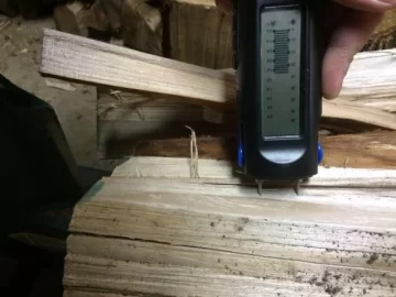

my wood ( 1 year Maple) is a bit wet, the meter says between 15 to 20% but the secondary flame quit early when the damper close, and the window doesn't clean itself.
Are you testing the wood on a fresh split face? Secondarys going away and dirty window says wet wood...you'll be much happier with this unit on 2 or 3 year dried wood
You are right, wood moisture content inside is more 20% to 25% inside

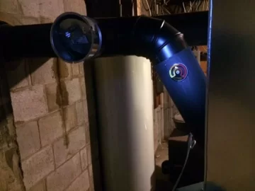

Temporary Setup, I will remove oil furnace and connect the caddy to the house duct

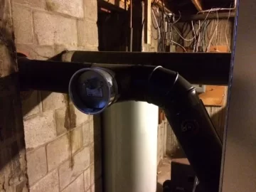

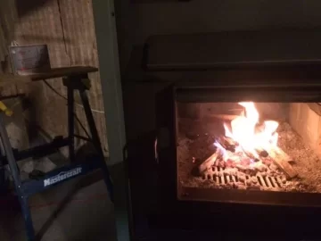

Chimey setup... and cold start of a fire

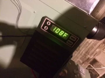

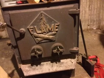

My Old wood stove that I replace... temp plenum during the cold loading

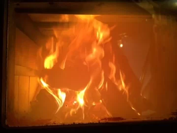

Fire after loading it... chimney temp is after 20 minutes of full damper open, plenum temp was standing still at 145F degree, burn time was about 3-4 hours with that load.

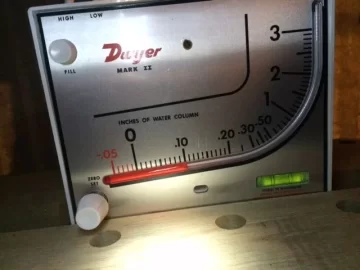

Manometer with damper full open after 20 minutes of open damper, it goes back to 0.8 at damper close
... I think i will at least add one washer to the baro... 4 washer = 0.06

It's a fresh split maple, one year dry, meter read between 20 and 25
The wet wood is limiting the heat output which keeps the damper open longer which keeps the draft high...it's a vicious circle. If you can get the 'stat satified long enough to let the damper close your burn times will sky rocket.
Why do you need to add washers to the baro? Is the sliding weight not enough? I have never seen a situation where weight had to be added to lower the draft unless there was creosote buildup on the back of the baro flapper door, or if the flapper was binding for some reason.
I have to add weight to mine. I have 36' vertical to the top of my chimney. Daryl (Kuuma) told me about a guy in Chicago who had a 45' chimney who actually added TWO BD's in order to get his draft within spec! :eek:
