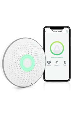

i Have an airthings wave radon detector. Simple to use with an easy to use app.
It works off your phones bluetooth.
Also moniters the temp and humidity and charts them out over time.
I have one in each house. They were about $40 but now i see them for $60-80 on different places including ebay.
No need to send in anything to a lab.
It will give you a good idea on whether you have problem levels or not. Radon is the 2nd biggest cause of lung cancer.
if you are pulling basement air in your main living space then you are pulling the radon with it.
i have one like this
