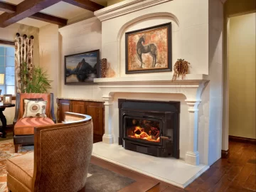

The Sequoia has a fan also, but the natural convection seems rather impressive to my very unskilled eye. Here is a look:

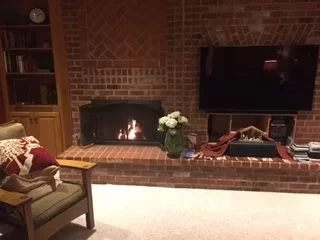

They are in full production of The Ashford insert. I've already installed one. Nice looking unit!
I thought someone had one, wasn't sure if I was mixing up units. I didn't see it on the BK site.
But isn't it a Sirocco insert, not an Ashford? I think it's even smaller than the princess insert, so probably not what the OP is needing.
Sirocco has square edge glass on top that one posted above has soft rounded edges. Looks a little differant to me, sure some one will know for sure.
