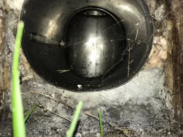

It looks like the liner stops just past the inlet from the stove. So the cleanout area has no liner. I don’t believe it is insulated.
Here’s a quick picture from the cleanout. Not much to see. But you can see a little of the end of the liner.
That is from the cleanout?
Yeah. So that is just below where the pipe from inside enters the chimney. So the picture was taken just looking straight in horizontally from outside the house with the cleanout door open.
Well there is a tee there so the liner is clearly extended down that is good. Is there a tee cap on the bottom of that tee?
Went and talked with someone at a wood stove dealer and we came to the conclusion that there is no tee cap. So the suggestions was that I get a cap or at the very least put some fire proof insulation in the clean out door to block off the lower part of the tee. Any thoughts on just doing that from anyone? Also where could I buy a tee cap and should I caulk that into place?

At this point putting a tee cap on would be very difficult
I was afraid of that and was thinking of ways to effectively block the lower part of the tee without pulling the liner up.
Just fill the bottom up with mortar of some sort.
