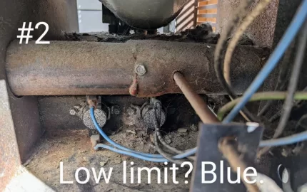

It's weird because I can't see a reset button. Please see the images. Thank you

The result. The low-limit snap switch (proof of fire) was faulty. I jumpered the switch and it has been running all morning!

ceramic snap discs are what is used on my low-limit switch
Enviro stove
