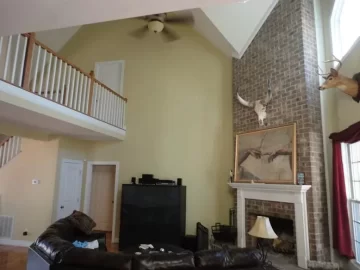

I have been reading tons of the posts and have read the good and bad about both stoves, the difference between cast iron and steel etc. Basically, Here is what I am looking at: I have a cape cod style home with high ceilings (20') in the living room and entry. The house is a pretty open floor plan. I have plenty of opening for either stove. The fireplace is on the wall in the center of the house (on 1st floor). I spend alot of time in the living room and have some concerns about the fan noise that comes up with the VC. As it never gets super cold here, it gets cold enough to kill me on power bills. I was going to pull the trigger yesterday on the Merrimack until the salesperson made some comments that made me rethink that for the moment. Any suggestions would be greatly appreciated.

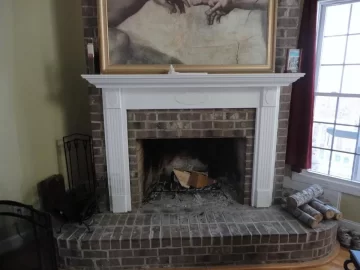

Is your fireplace masonry? Make sure it is not a prefab (zero clearance) fireplace, you will have to get a special insert to go in that if it is.
Got some pictures and dimensions of your fireplace? Helps us to make sure your fireplace will have the clearance minimums met.

Here are pictures of my masonry fireplace as well as the type of space (high ceilings) I am dealing with. Openings are 40"w x 31"h x 19" deep at top 22.5" deep at the bottem. I like the 2200 because of the bay window. I am considering the 2400 osburn due to a bigger box and possible longer burns, but it doesn't have the asthetic appeal as the 2200 with the bay door.. Have about ruled out the Merrimack. Suggestions?. Again, the room is 2400-2800sqft.

You need to check the clearances with that mantle being so close on the sides.
Osburn 2200 insert:
Minimum clearances to combustibles *
(Data expressed in inches. 1 inch = 25.4 mm)
Combustible side wall to unit
17"
Combustible side mantle to unit
10"
Combustible top mantle to unit
14"
Combustible top shelf to unit
22"
Minimum floor protection in front of unit
16"USA / 18"CAN
Projection in the room minimum / maximum
10.5" / 10.5"
I am gonna remove that entire mantel and I am building one. So do you think the 2200 will do the trick?
