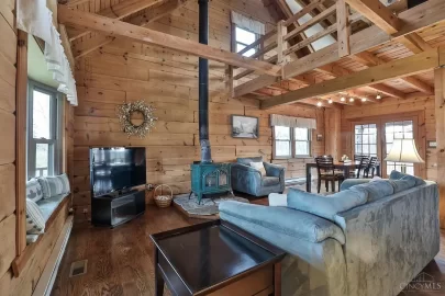

So, I am planning to swap out the VC Defiant with the new Enerzone 3.5. My question is does the 8" pipe that is there currently hanging that is screwed together stay in place once I remove the VC stove from under the pipe? The pipe has a straight drop of about 13' to current stove. I have not done a swap out before but I have watched an install a few times online! :) I would like to think the pipe will stay in place but others have way more experience doing a stove swap. Any thoughts? I am anxious to get this project completed and the Enerzone out of the front living room floor. I am removing the lower hearth and insetting a tile base into the hardwood so its flush and not a toe stubber anymore!

Only the top section is double wall the rest of the pipe is single wall. Once I unhook the stove and move it out of the way will the pipe be able to stay in place hanging while I get the new stove installed or do I need to remove the whole pipe to keep it from sliding down without being connected to the new stove?
I'd verify the piping coming down is all mechanically connected together with screws (it should be). Taking the stove away and it not being supported (the hanging pipe) might be an adventure waiting to happen... Is the pipe clean? Probably would be a good idea to consider replacing the connector piping to 6" double wall. Remember it will work better, will last thereafter and is a better install. Yes it is expensive, but man that's a lot of connector piping. Good luck with it, BTW, beautiful home too! Take care.
Thank you for the compliment. I have been working on it getting things finished up. Yes the pipe has mechanical fasteners.. "Screwed together each section". DO you think the pipe would still stay together being mechanically fastened together. The wife wants new dbl wall 6" pipe to push the stove closer to the wall to free up floor space but ouch it is pricey instead of keeping the current 8" pipe.
If fastened together with screws, I'm thinking it would hold itself up. I heard the words "the wife wants though" . Best to replace the pipe. Stay warm, stay happy.
