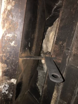

Hello,
I’ve been looking around this forum trying to find some information and have been impressed with the quality of responses. Hopefully, someone has some insight for me as well.
I recently moved into a new house and I would like to put a wood stove in the downstairs fireplace. The opening is a bit small though so I was thinking of trying to widen it. My old home had a blaze king princess so I would love that to be an option again. If not other recommendations are welcomed. Perhaps an insert is the only option?
Anyway, in an ideal world my idea is to rip out the raised hearth and chip out the bottom of the fireplace to take it down to floor level. Current opening is 33” wide but tapers down to 29.5” at the back. Top of arch is 24.5”. From the bottom of the fireplace to floor level is another 20”. Current depth is 24”. Fireplace vintage is circa 1978ish.
Is this à realistic plan? Pretty sure the hearth is just concrete and presumably some rebar covered with tile?
Here are some photos. Also not sure what to make of the odd damper above fire box. I’ve only had wood stoves and never a fireplace before.

Hello,
Here are some photos. Also not sure what to make of the odd damper above fire box. I’ve only had wood stoves and never a fireplace before.View attachment 329812View attachment 329813View attachment 329814

I think the problem with the insert is the arch at the top of the fireplace. After doing a quick check of the insert dimensions it seems the width and depth are fine but the archway will catch the corner of the insert. About 3.5” off

Is it hollow behind the arch corners with a straight lintel? If so, could the opening be squared up by cutting into the arch?
In this location, a Princess insert might put out more heat due to its convective jacket design.
Yes it is hollow behind the arch so that could definitely be an option. The shroud would cover up the arch anyway. Thanks
