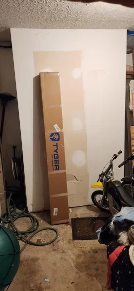

I’ve been reading this forum for over a year now and just joined (and now posting). I helped my mom research and pick out an Ashford 25 fireplace insert (brown enamel) for the family farm house. After a few burns on it, I am hooked (I was always hooked on burning wood, but this insert has me staring at it for hours). We’ve always cut firewood and used a whole house wood furnace with supply/return ducting on the farm. I like to cut firewood and currently burn it in a zero clearance fireplace at my house on our main floor (Majestic WarmMajic WM36). My wife likes to hear the fire with the doors open, so I can’t change that one. We have another zero clearance fireplace in our walk-out basement where I spend a lot of time (office). It’s actually a propane insert, a Monesson DEB24/30PH, which is a 24” long burner unvented propane gas log fireplace rated for 38,000 BTUs. It has a chimney (I think 8” chimney, double wall), but the current propane heater is ventless. I’m guessing the previous owners installed the ventless propane insert and just left the chimney in place. The metal insert/surround has not been cut for the chimney…so the ventless design is still ventless.
I’d like to install an Ashford 25 fireplace insert (#1 preference) without changing the unique, large granite wall that has a 38” wide by 33” tall opening. Behind the wall is our garage where the framing/box is for the current fireplace. If any changes are needed, we can modify and/or build an entire new enclosure in the garage (can can install the fireplace insert from the back if needed).

There is plenty of room to install the Ashford insert into the current layout. Both of my current fireplaces are enclosed in the same chase that run from the garage to the attic/roof and have their own chimneys.

I've included pictures of the propane insert, the roof/chimneys (smaller one goes to propane insert), and the garage area (back of propane insert).

The gas fireplace can not have an insert put in it. There are several reasons why including supporting the weight of the insert, different type of flue, unlikely to fit, and probably there is strong language in the ZC manual saying it's not allowed.
Now, the idea of putting in a woodstove in front that is rear-vented into a 6" insulated liner is an intriguing one. If possible, it won't be a BK.
Putting in a BK behind the granite facade is also unlikely due to alcove installation constraints. The clearances would be wrong.
Search on this site "Blaze King Alcove". Members post in detail their projects.
