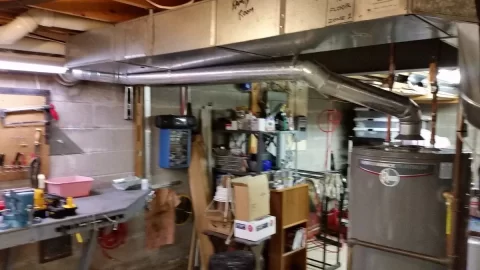

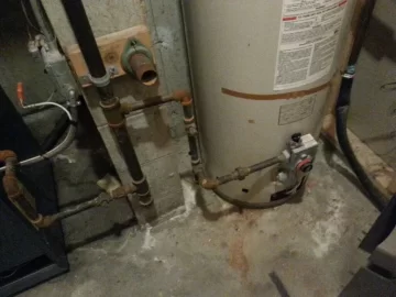

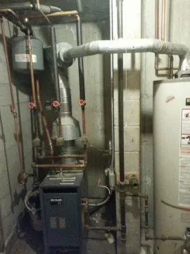

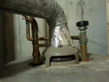

Just got a $1900 estimate to replace a gas fired WH and run new vent pipe for WH and boiler which are now hood vented. This is a summer house mainly, so standard no frills WH is fine.
Can I do this myself, is it a DIY thing? Here's my setup:
[Hearth.com] Can I replace a water heater?
I dont know can you? lol. It is not hard but We have no idea what your skill level is or what local regulations require when it comes to working on gas appliances.
Okay, what would be the necessary skill level to do it? The plumber who gave the estimate said direct vent is code. I see 3 connections, water in, out and gas in. Can't I just get the same basic model and replace as is.
I just replaced my gas water heater. I was very comfortable cutting and sweating copper pipe and the gas connection was basically unhooking existing pipe, doping and reconnecting to the new hot water heater. Everything lined up perfect. All depending on your abilities.
