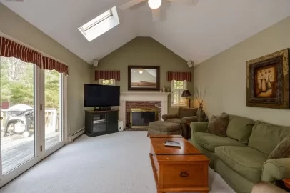

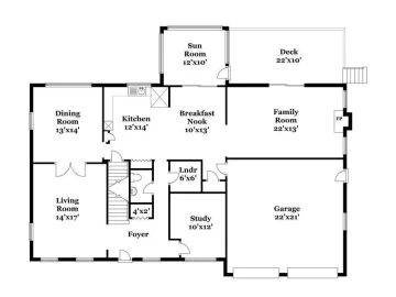

There is one fireplace in the house, with a good tall outside chimney. I've included the floor plan below. I expect we'll spend a lot of time in the kitchen and den (pictured). That room faces south/west so we'll get good afternoon sun (and we will be putting PV solar on the roof).
There is a full finished basement, and the master bedroom is above the garage. I'm not expecting to get much, if any, heat from the greatroom up the stairs...
The best place for our every-day TV is on the back wall...near where their TV currently is...but not up against the fireplace...
Thinking about the BK 30 series stoves...not an insert, but a free standing stove. I've got 3-4 cords of seasoned wood that I will bring to the new house.

I'm thinking the Ashford 30 would be ideal...the Chinook might be too modern for that space. (Ignore the current furniture, it's not ours...)

I just noticed that the BKs are designed to have a vertical run of stove pipe...not sure this will work given the size of the fireplace. Maybe I'm looking at one of the new BK inserts...

Fireplace dimensions will dictate what will fit. Looks like it may need to be a BK Princess insert if there's room.
Thanks, if that's the case I might lean towards the coming BK 25 inserts. I'll take measurements later this week during the home inspection...
I didn't understand your abbreviations but didn't matter, you probably have to go with an insert, the new Ashford insert is nice, thinking of getting it myself as a second stove.
