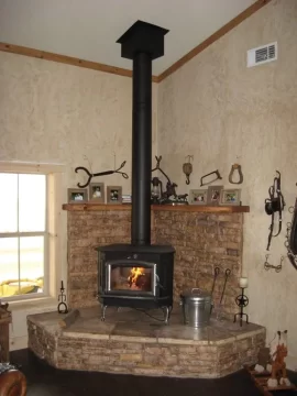

This is my corner install
NO fireplace needed :coolsmile:

Took a corner of living room partitioned it off, and the built the hearth to fit the clearance box, and direct vented outside
and then just add the pretty, like tile and a nice wood mantle. :coolsmirk:

I did all the framing and stove install, but I had a tile guy do the tile, and a cabinet guy do the mantel.
As for price$$$$
Stove around $2800
Tile&labor;$200
Mantel&labor;$400
Framing material $100
This is a pretty close estimate
There is a bigger pic in the picture forum under 2 new stoves

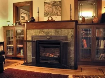

Doubledip gave wise council when he said, you can have whatever you want, but it will cost you. This is going to be an expensive proposition, so it's good to weigh all the pros and cons. If the goal is heat, maybe get a beautiful freestanding stove and give it an attractive hearth that sets it off as well as a formal mantel would. Or there are zero clearance fireplaces that are also good heaters that also can be considered. These units can have the formal surround and mantel. Here are some links to ZC fireplaces:
(broken link removed to http://www.icc-rsf.com/en/rsf/RSF_Fireplaces___Woodburning_fireplaces)
(broken link removed to http://www.kozyheat.com/products/woodburning/231zc/index.html)

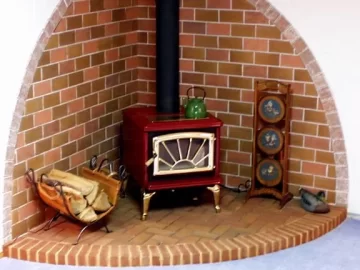

And here are some freestanding ideas for corner installs. They would work fine for pellet or wood burning stoves. Give your minds permission to explore the traditional and non traditional. 2stoves beautiful work is an example of what can be done with some creative forethought. Ultimately the setting for the heater is up to your imagination.

  • [Hearth.com] Can I use a stove insert without an existing chimney?

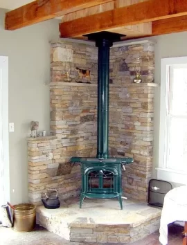

If you have reasonable NG, that's what I'd put in. It's very likely cost competitive with pellets. You can have it look just about as trick as you want and still have the mantel. The flue is straight out the back. Here's a shot of my friend's Valor installation. Let your imagination have at it!
