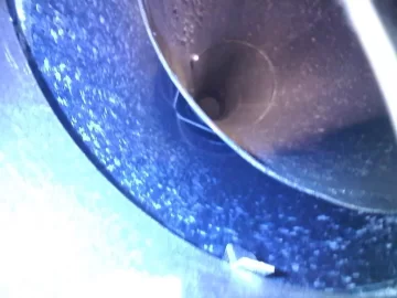

I have the same question and dont want to hijack your thread but my fireplace is installed already and it has a double wall pipe and it sounds like I will need a liner also. I am planning to install a Vermont Castings wood burner.
Here is a pick of my chimney pipe looking from where the old fireplace insert used to be up.

Thumper, start you're own thread.
I think you'll get more help.
