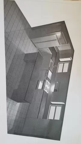

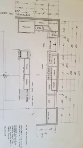

Bumping this up. Cabinets have been ordered and I bought 4 inch LED low profile lights. I am attaching 2 pictures of the area. Any input on where to place them would be great. I'd rather have to many and put them on a dimmer then dark spots. There will be a light over the sink and on the island (wife hasn't decided that yet) I am going to run some low voltage under cabinet lighting. 20200407_092847.jpg 20200407_092839.jpg

That island is almost 10 feet long, it needs three pendants to properly light it.

This island is 10'6'' long. Lighting is Par16, 3000k 40 degree flood, 500 lumen LED.​
If you put a light centered on the fridge, make sure it's a few inches in front of the face of the fridge(if it's not a counter depth fridge), not the upper cabinet - otherwise it will cast a short dark shadow in front of the fridge.​

Good to know. I'm still trying to decide to put a light in front of the fridge and stove or space everything evenly on the ceiling then have under cabinet lights, sink light, and island hanging lights. I'm seeing all kinds of different lay outs when I browse the web.
