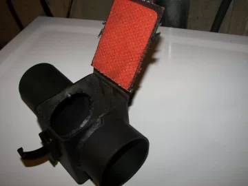

Based on your numbers you are only looking at 11 EVL which is fine for even 3". I wonder if you could make something like posted below work for an easy clean out. Pics of your venting would help also.
  • [Hearth.com] Can pressure sense time be extended on Breckwell P23?
