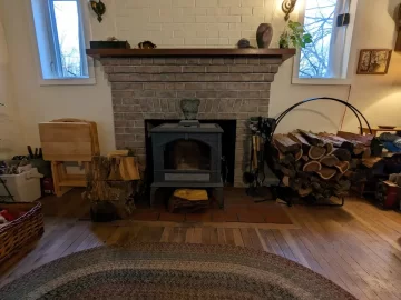

As you'll see, if you haven't already, learning about all the options she has at this point is a steep learning curve. _g Now, don't go lighting your stove with wood this close! I was hauling it in and throwing it there temporarily until I made more room. That was when the cold snap was on the way. :oops:
Love this set up. And no way is that wood too Close.
The Castine is a highly radiant stove with a side clearance of 19". The wood is too close.
Put your glasses on Begreen 😂 that’s a Keystone with a side clearance of 18”.
Reactions: Woody Stover
"And no way is that wood to close"
Well that was kind of joke.
Reactions: stoveliker
Shirley you jest.
Yes, and the wood on the left appears closer than that. My mistake for cross posting. It was in reference to Big e's earlier post:
