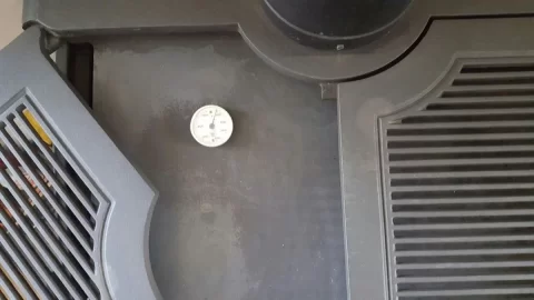

Here's where I have the stove top thermometer. It's positioned so that I can view it thru the trivet.

Thanks begreen I will put the thermometer in that spot, I think the new improved door catch should help.
