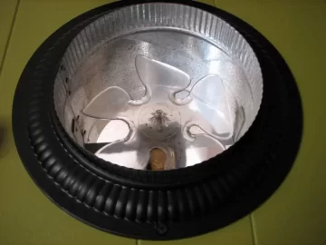

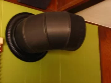

You could install a through the wall duct Fan with dimmer switch.
Stick a 90º swivel elbow on to direct air to suit your situation. Works great for me : )

hey caz that seems like a good idea that just might work...how did you wire it in? what size pipe did you get? and does the fan cool the air or is it still really warm when it goes through the fan? I just tried the door way fans and doesnt seem to work that good....the room i want to heat is the next room over from the stove room...so i think i have to cut a hole in the wall and put a vent or a fan...
FJL,
It is an 8" duct fan and pipe. Comes with a wiring diagram. Air comes through the fan nice and warm.
I run mine on medium speed to warm 2 bedrooms and 1 bath. It is also fairly quiet : )
