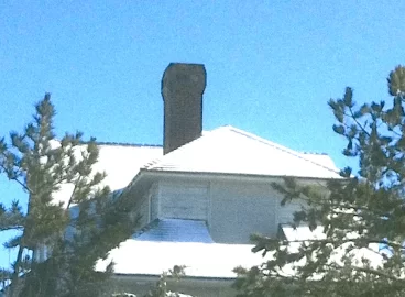

We are moving into a house which I have been renting out for the past few years and would love to put a fireplace insert in it. We love the Regency we have at our present home.
But the installer crew that came to inspect the setup and give me an estimate says the chimney cannot accept a liner unless I spend big money to remove its top. It has a flat, closed top, all brick, with screened vents on all four sides, through which the smoke escapes.
They said I would have to hire a mason to remove at least four courses of bricks, which on this two-story house means scaffolding.
Obviously I need to get a mason to look at this, but I'm pretty discouraged.
Any thoughts or suggestions from the collective brains here?

Picture time.
Bart,
I will be there tomorrow and try to get a decent shot, but be aware that there is no way to get a pic of the important part -- the top -- due to the height.
Here's a blurry enlargement from last winter that may at least give a rough idea.

It's a bit of a challenge. Depends a lot on access through the side vents at the top and just what it looks like inside. Flex liners can be put up from the bottom, but then there's work to be done at the top to secure, support, and seal it. It's probably not impossible, but it's not a slam-dunk. Work up top is gonna require a bucket truck or scaffolding, it would appear. You need to talk to someone with a bit more imagination and ambition than the crew you talked with. Rick
Reactions: danham
Its entirely possible that is true there are some chimneys that cant be done or some that need serious modification to be lined we need better pics to tell anything

It sounds like mostly demolition work. Of course its on a treacherous roof top, and if you want it done right and look nice a mason doing it would be preferable.
I am assuming the entire top needs to be removed because it is like a brick roof with openings on the side only.
Instinctively, it would seem, you only need a 6 inch hole bashed into the top of the brick to fit and drop a liner down that would then have the screen jut out over the top of the brick.
Realistically that sounds like a heck of a major chore and If I did it it would look like a hack job and I might realistically break my neck and die trying because of that roof.
So to me it does look like a chore for a professional and be quiet expensive because someone has to do it safely and that costs money, and have it done aesthetically as well and that takes money. Getting up there and demoing the top of chimney is probably not a chore many want to undertake.
We do stuff like that masons in our area would not touch that. But it is not going to be cheap just because of the access you will either need an elaborate scaffold setup of a lift for a week either way it wont come cheap Unless like others have said a hole could just be cut in the top in that case it could be not that bad still need a lift or roof setup but not as much as if the top was being rebuilt.
I think you need to start getting quotes, maybe separate the chimney modification from the liner install - unless you find an outfit qualified to do both.
Good luck to you!
Most sweeps i know do the masonry work as well i dont know if it is the same in ma though
How hard would it be to cut a 6" hole in that cement lid? (outside of the obvious need for a lift or scaffolding)
Tha tdepends on how it was made it could be a real pain in the ass and you would need bigger than 6" but that is probably the first approach i would consider
