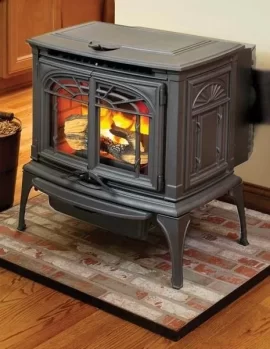

Lopi Leyden
Thats nice..... Lopi. I bet those fake logs are a pita as well as the smallish ashpan. I wonder where those ornate castings are made at?
