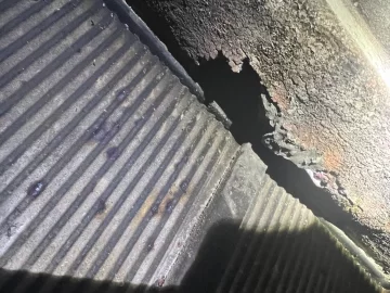

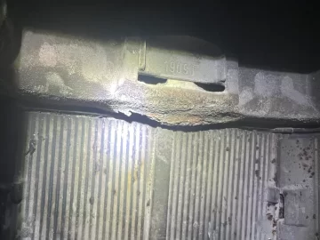

I’m also interested in the repair to your stove. I have an OSK 3 and the cast iron heat baffle has a hole in it right under and in front of the flue. So far I don’t believe the firebox is damaged but I’d like to repair/replace that baffle. Here are some photos:
