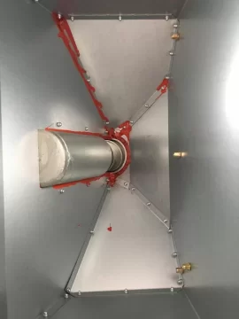

All of this said, i got the manual and the electronic panel out of the hopper and found gooey stuff ( i guess is fireproof sealant) but only in certain areas (see pic below).
any other owners noticed that? Should i put more sealant on the rest of the edges just for good measure?
