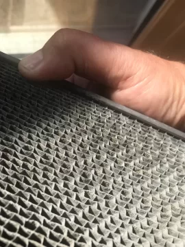

Thanks for the quick reply. Your help is much appreciated. This was my third year and it is the first time I clean the CAT. No black smoke but I noticed that I am using more wood for the same amount of heat. My wood was splitted too thick and I realized that some of it was still relatively wet in the center. When I removed the CAT, I noticed that the gasket around it was worned out. The holes within the CAT were not clogged but there was a thick coating of ash inside each one of the holes. After cleaning there is definitely a thin film of ash covering each one of the holes. I wonder if it is possible that this film will prevent the proper functionality of the CAT. I have around 10 000 hours of use and the wood stove and pipe were bought brand new 3 years ago.

That photo was after you blew out the cat with compressed air? Nice photo btw.
Higher wood consumption, hard deposits on the cat, higher than normal creosote accumulation, over 10,000 hours, I wouldn't waste money on a gasket I would buy a new cat.

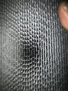

The picture was taken after I cleaned it with compressed air. I will order a new CAT before next season and a couple of gasket from Firecat. I think I will first try to clean the old one with water in order to dislodge the film of ash. If it doesn’t work I will do the vinegar bath procedure. I should have plenty of dry wood for next winter since I made myself a couple of new rack and most of my firewood for this year was stacked and covered 3 years ago

I am under the impression that those residues would not burn, even at higher temperature. This looks like a mineral (ash) deposit. Do you guys clean the CAT with air after each season? I never cleaned it and maybe that’s why residues are now baked on it. It still glows but maybe the residues makes it less efficient.

The picture was taken after I cleaned it with compressed air. I will order a new CAT before next season and a couple of gasket from Firecat. I think I will first try to clean the old one with water in order to dislodge the film of ash. If it doesn’t work I will do the vinegar bath procedure. I should have plenty of dry wood for next winter since I made myself a couple of new rack and most of my firewood for this year was stacked and covered 3 years ago View attachment 245353
Use distilled water for cleaning.
Tap water has minerals in it, and the minerals will mask the catalyst after the water evaporates.
A good cleaning now that it is out is good but a hot burn once in a while can do good also, at least with the ceramic cat. The SS cat with the tendency to get clogged I don't know but a good hot burn always is good.

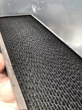

I cleaned it with distilled water the best I could without scrubbing... I was expecting a better result
That’s why you’re supposed to use vinegar. The vinegar is an acid and will dissolve mineral deposits that look like crust. Then you neutralize the acid with distilled water to stop the reaction. The water doesn’t clean anything.
The very thin catalyst layer is setting invisibley close to the metal so anything you can see on top of the metal is masking the catalyst so it can’t eat smoke. It should look like new even when the cat is dead.

It's supposed to look 'dirty'. The wash coat is high surface area aluminum oxide, so it will look non-reflective and oxidized right from the factory.
I don't think the naked eye can tell much difference between a new cat and a cat with some masking.
I’m with you jetsam. The photo of accumulated shmuck on it earlier in the thread was a lot of debris that will mask the catalyst.
A new, or clean cat will have a dull appearance. Almost brown like it’s dirty but no buildup of debris.

There are still chunks of dirt caked on one side of the CAT. The picture is not too good. I will get distilled vinegar tomorrow at the supermarket and get more distilled water. I was under the impression that the vinegar bath was a last resort kind of thing. This CAT was still glowing red last winter. Is it possible that it is glowing red without eating up the smoke. I will also order a new CAT and the 2 inch gasket from firecat this week.

Yeah, the chunky stuff in the first photo was just big chunks of ash, which you can vaccum or rinse off. Mineral deposits are what the vinegar's for, and they are not really visible (my cat didn't look terribly different after being boiled in vinegar, and it probably had above-average mineral deposits due to having had to deal with some really terrible wet wood over the years).
