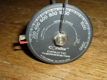

I engage the cat from a cold stove once the cat probe thermometer reads active. That's somewhere between 200* and 250* stove top according to my Rutland stove top thermo that's not "exactly" accurate.
On a hot reload, if the cat probe thermo reads active I still give it a few minutes to start moving upward before re-engaging.

From a cold start I'll close the bypass just before the cat is ready to go active on the probe since the probe lags and it's probably already there. On a hot start where the probe is showing active already I close it when I see an active fire.
