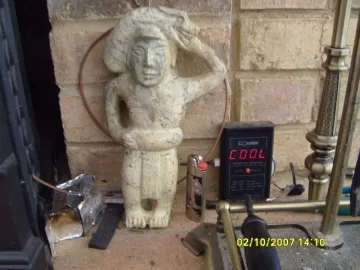

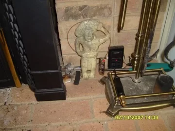

Hey Mo. You mentioned your cat thermometer is digital. Is the digital readout close to the stove? I am just wondering what keeps the thing from melting?
It's next to the stove. The WWL's side pedistals are like heat shields, it doesn't even get warm over there. You may not know that the digital readout box is only one of the two parts of the thermometer. The other is a braided copper conductor with the probe on one end and a terminal that plugs into the readout on the other. It transmits some sort of a signal from the probe, which is inserted into the back of the firebox all the way through the refractory can and into the cat combustion chamber, just downstream of the cat exhaust. I guess the probe is a thermopile, but I'm not really sure.
Here's a link to the Condar site and my thermometer. They've even added a photo of the WWL since I was here last.
(broken link removed to http://www.condar.com/digital.htm)
Here is a photo of my thermometer next to the stove.

Here's another a bit closer up.
[edit: If you look closely to the right, you can see the 9-volt pig tail adapter from my 110V AC to 9V DC power converter that saves tons of batteries. A real must-have if you get one of these. I bought it at Radio Shack, but you can get them lots of places.]

thanks, Mo. I'll have to check those out.
