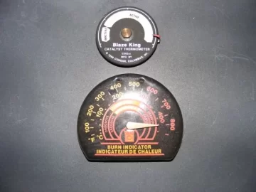

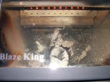

    this is what I have going today at this time. Loaded at this am. Some pine and poplar 3/4 load 4hrs into burn and smoldering. Will get 12 hrs min for sure out of it. High temps above the cat but 400F at the rest of stove top locations. Been doing this since day one in mild outside temps. YR5. CAT still purring along like a kitten.
    Not a inline filter Soup. A heat source that smoke fuels.
