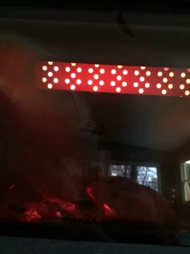

That kind of glowing, my cat thermometer does not have numbers my stove top reads 600 no flames.Is it ok? I'm worried that it can damage the cat.
I imagine this is on your stove and not your insert since you said you don't have an actual temperature reading. I have seen similar glowing on my insert and the temperature was indicating around 1000F.
Correct it's the stove not the insert. I just want to make sure it's not to much heat for the cat.

When the cat is burning hot I can see it glowing red, from reading here I thought that was good.
Yep, that's fine. I just don't like to see it pushing bright orange or yellow. It doesn't sound like that is what you're seeing, though.
