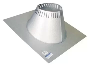

I have old metalbestos 7" pipe and the only flashing I found locally is for 6" or 8". I bought the 6" thinking it would fit through but it just barely doesn't. The picture is the same stuff I have. I wonder if I'd be able to cut through 2 or so of the slits to the top to make the pipe fit through?
