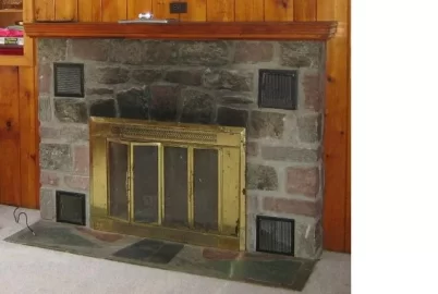

I am buying a house in Northern New Jersey, and my inspector has said that the firebox is rusted thru on the fireplace and that there is no damper, and that the wood stove (other room) is shot because there is rust thru on the chimney and where the chimney connects to the stove (the damper knob (?) just is hanging there and controls nothing). My questions are:
1. For the fireplace, I have seen stove inserts and plain fireplace (inserts?). Am I correct in understanding that both of these items slide in to the existing opening? If so for both, other then one being less expensive, what is the difference? I would like to just be able to throw some logs in the thing and watch them burn. I am not specifically looking for heating as the purpose for such, but obviously would not be opposed to lowering the heating bill. The fireplace is located in the center of the ranch home. It shares (seperate flues) the chimney with the Oil heat/Forced air system.
In addition, for both of these units, is it possible to just run a SS Chimney up the old mason Chimney?

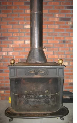

2. The wood stove seems to have rust all over. (Pictures attatched) What difficulties are there in repainting(?) it and finding the right equipment to replace the chimney? The chimney currently is straight up and out the roof, is there any difference if I had the chimney on the roof removed and had it piped out the back wall of the room?
Thank you in adavance for sharing your wisdom. All I want to do is have both units functioning, the Fireplace more then the Stove. I figure worse comes to worse on the stove I just get a new one. When answering if you could give possibly a rough exspense estimate, basic to fancy.

I sure great advice is comming but your stove is a pice of ##### not worth fixing it it never was a decent stove what you really have is a death trap

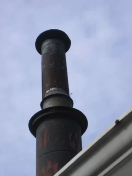

also the vent pipe connected to is junk especially including the roof section

That puppy looks like an old "Franklin" stove. Yup, invented by ol' Ben himself! They became very popular in the 70s. And it looks like the owner got his money's worth. Time to say 'buh bye".
A replacement stove could run about 2 grand complate with chimney and installation. But the new ones are EPA approved and will last a long time. And use a LOT LESS wood!

That sounds like you can not put an insert into that fireplace. The firebox of a fireplace needs to be intact, and a metal one is probably a prefab that is not in good enough shape to install an insert into. As far as the Stove, that probably needs to be replaced, and I'd recommend a Harman or Vermont Castings with a n 8" chimney as those can be used with a screen in place so they work like a fireplace. I think SOME Jotul's can do that also.

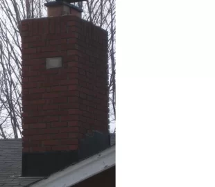

Looking at your chimney cap on the masonry chimney. Is there one top covering both tile vents? If so you are at risk of CO or smoke getting into your house, as one vents gas the other could suck in cold air and gases back into your home.
I believe that there are two separate caps, I will Check again. The House was built 1948. The set up you just described...how much would that run about?

I would only look at modern stoves, EPA passed and UL Listed; catalitic converter or secondary burn wood burning appliances. Look for dealers in your area to see what you want. Insert or free standing stove? Your choice. When planning research here most stove models have owners how can answer questions. I am a soapstone free standing guy.
Two caps at the same height that close could still be a problem.

Tackling one appliance at the time seems wisest. I would look at just what sort of chimney you have now, and what it will take to make it work. There are actually two different parts to think about, one is the actual outer chimney structure, the other is the flue inside the chimney that the smoke will go through...
Is it a real masonry chimney? Or is it some sort of prefab shell? If it is a real chimney, what are the liners made out of, what size are they, and what kind of shape are they in? Does the chimney structure have proper clearances? Do you have a "straight shot" up the chimney from the firebox, or are their bends involved? How big is the damper opening at the top of the fire box? If there are two flues in the chimney, what does the other flue service? What kind of shape is the second flue in? Is the existing firebox a ZC (zero clearance) box, or a metal "heating fireplace" such as those made by Heatilator for many years?
IF it is a "real" chimney, with clay liners and not to many bends on the way up, it won't be that hard to drop an insulated stainless liner down the chimney which can hook up to an insert with minimal problems. If it is a ZC firebox, then it's a bit trickier as you have to use an insert that is tested and approved for use in a ZC fireplace.
In general, you want to keep as much of your chimney inside the house as you can. It is posible to run a chimney (masonry or prefab metal) up an outside wall, but those installs tend to have far more problems with draft, creosote buildup, etc. By keeping the chimney inside, you get more efficient heating, better draft, and less creosote because a warm chimney works better and an inside chimney stays warmer.

The first thing you need to do is figure out whether you have a "Heatform" type fireplace (see this link for a Wiki article describing them.) or a "Zero Clearance" fireplace. We don't seem to have an Wiki article on ZC's yet unfortuneately, (and I don't feel qualified to write one) but in short a ZC box is a super cheap pre-fab fireplace and chimney setup that some builders use to make a fireplace in a house without going to the trouble and expense of building a masonry chimney and firebox. They call it a ZC because the design allows them to build the wooden house structure right next to the box, without the usuall required clearances to combustibles. This causes problems later as attempting to install something later will have problems because you have wooden structural parts to close for safety. This article gives a very short description of the problems a ZC causes.
Hopefully it's a Heatform, as those give you more options, since they basically can be treated the same way as a masonry fireplace. That you have a masonry chimney is a good sign.

The other setup will involve removing the existing prefab chimney setup, and putting in a new one. As I understand it, this is pretty much just basic carpentry and screwing the parts together, not really harder or more complex than any other job of that sort. In both cases, If you are handy and don't mind roof work, it shouldn't be that much of a problem, we have lots of successful DIY installs on the board. You will probably find a few places where having a few buddies to lend a hand will really help out - a lot of the stuff is heavy or awkward to move single handedly, not the least of which are the stoves themselves.

Your fireplace setup looks almost exactly like mine. Mine is an old 1960's Heatilator. Those 4 vents give it away.
Is the steel in the firebox thick as in 3/16"-1/4"? or thinner? Check in an unrusted spot..
If it is a Heatilator, you can put an insert & reline the masonry chimney with a full stainless steel liner.
To answer your question on the stove and changing the stack from going through roof to going through wall. I wouldn't do that, and this is why..........
A straight up shot will give optimal draft. Elbowing it through a wall will hamper draft, and the elbows are prone to creosote buildup.
The holes are all cut for your new straight up piping. No need to patch ceiling, roof etc. No need to cut new hole in wall.
Basically your all set, why make more work for a possibly less than optimal set up?
Moving along with my inspections for getting the house. The four vents are purely gravity drawn, there is no blower. I am going tomorrow for somethings and I am going to look into the Chimney better. I will also check the firebox. I look forward to some "snake wrestling".
Not all Heatilators had blowers... We had a summer cottage when I was growing up that had a heatilator fireplace in it. That unit didn't have any vents on the front, just an inlet near the floor on each side and an outlet near the ceiling. Purely convection / gravity driven.

I agree with Goose, my healitaltor was set up exactly as yours, same vent placement and all. No blower. The cooler room air came from near the floor into the bottom vents, wenht along side the heatilator and out the top vents. Mine were closed off when I bought the place. I popped one open to see the path and what it was & did.
