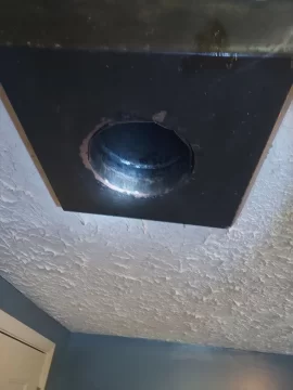

Need help figuring out this box. Shouldn't this end be female coming out out box? Seems like creosote would drip on outside,cause only female pipe fits inside.
[Hearth.com] Ceiling box

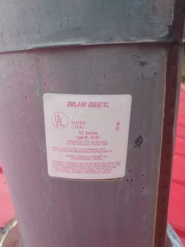

Yes there is probably an adapter missing. Can you find a label on the pipe anywhere?
