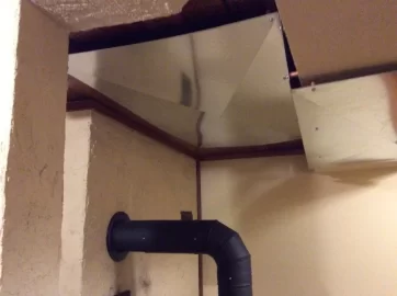

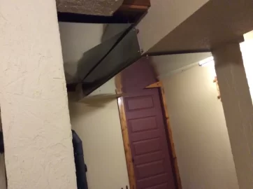

Shielding can be used to reduce ceiling clearances. As I did here.

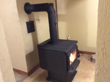

Now I see you went out the side, unless that is a chimney behind it. I have windows behind the stove with a 1' overhang. Any way i look at it. I think I am going to run into problems. The room where the stove will sit was once the deck. I put on this room to hold a hot tub. Tub is gone, but the room is still there. glass windows go all of the way around. If I go straight out the roof after looking at all of the info The chimney might have to go up 16' to just hit the peak of the house roof. I really don't want to, but I could raise the roof..
Now I see you went threw the wall, unless that is a chimney there. Now I really don't want to raise the roof. That would be a major job. Still I see a major problem where it talks about how high to have the stove pipe. This room is attached to the main house. The peak of the house is maybe 16' above this roof.
That is an interior masonry chimney it vents into.
