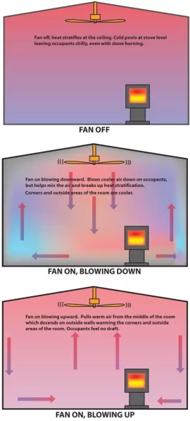

I have a Neo 2.5 insert and it is located in the back lounge - the lounge has high ceilings ~ 20 feet high with a fan - the fan doesn't work ie its broke - is it worth fixing the fan to try and reclaim all the heat from the high ceiling space?
In other words are ceiling fans any good at bringing the heat back down to living areas? Any one have ceiling fans and if so how good do they work?
