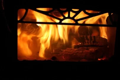

  • [Hearth.com] Century FW300010 over firing question
