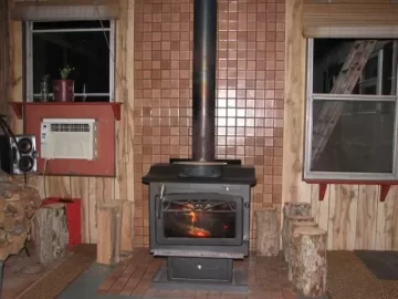

I have a CH Model: FW300010 that i use to completely heat my home. Haven't turned on the baseboard heat since i installed it.
(Thats been 4 years) Looking at replacing the firebrick next year. Can i get it from the factory or do i need to go through Lowes ?
Thanks in advance, for any help : ) Caz

Did you measure the brick size? Typical stock bricks are 4x8 and 4.5x9 - about 1 1 /4 thick. Most stoves have a couple pieces (cut) also. These sizes are easily available at masonry supply yards, some stove dealers and even online. That will generally be much easier than getting factory parts.
Go to your local concrete yard. I picked up some firebrick for my Century for a couple bucks each. Mine are normal sized except for 2 that have been cut.

Thanks for the info guys. I'll check out my local purveyor of bricks.

Ya, you should be able to get the firebricks just about anywhere.

trust me, if you cannot get locally , try the manufacturer first , lowes will just have to order from factory anyway , you should get what you want faster through the factory and they will likely ship right to your door (we do) as opposed to having to go to lowes to pick them up.
