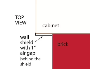

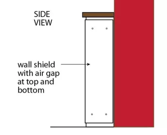

The wall shield mounts on the cabinet side, not the brick. From the top, it would look like an L with one side being the depth of the cabinet (~4") and the L leg being a narrow 1.5".
Would the gap between the edge of the shield and the brick need to be sealed or is just a snug "butted up against" fit be ok?
The part of the shield that wraps around the front of the cabinet...it should be spaced the same as the side portion?

No need to seal the gap where it meets the brick. The short leg of the shield that wraps to the front of the cabinet does not need the air gap. It should be flush with the cabinet for a better look.
Actually it probably doesn't need the L leg at all if you don't like that look. It could just have the front edge bent in at a 45 so that it meets the corner of the cabinet. If you chose that style I would have them hem (fold over) the front edge for a cleaner look.
BeGreen, thanks for the drawing and feedback. You answered my questions even before I could ask the questions! That's pretty good! Your drawing explained things nicely
