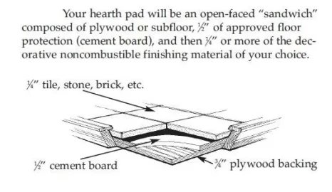

I had pretty much decided on the F3CB and had been researching building a R=1.1 hearth pad, had actually gotten some quotes on stoves, and was going to look at some stoves Monday or Tuesday on the way back from north Georgia.
I figured I'd go ahead and build a hearth that would cover the existing white ceramic tile hearth and would (hopefully) look nice when I got through. I was going to build it "portable", in other words *not* screwed down to the wood floor but rely upon the weight to hold things in place. My hearth layers were pretty much basic....
[Hearth.com] Certifiable nut looking for a stove (insert?) in south Alabama
This morning that little dim-wit light came on in my head and warning buzzers started sounding. That 27" lintel has struck again.
22-9/16" center of rear flue (plus) 3" to top of rear flue (equals) 25-9/16"
27" lintel height (minus) 25-9/16" top of rear flue (equals) 1-7/16" clearance above flue
2-3/4" proposed hearth thickness is not going to fit in 1-7/16"......<duh, I'm ah genius!>
If I cut the plywood back to 1/2" and do away with the thinset other than between the durock and the tiles that will bring the height down to only about 2"....still 9/16" too tall.
The Morso 2110 requires a R=1.0 floor protection so going that route isn't an option, being as that's about where I'm at with the F3CB.

Yep, you are getting the picture correctly, though the troweled thinset will be more like +1/8".
I'd be looking at the Woodstock, especially in your climate. It has an easier hearth requirement. With their requirements you could just remove a section of flooring in front of the existing hearth, then lay down some cement board and tile to extend it.
An insert would work too.
  • [Hearth.com] Certifiable nut looking for a stove (insert?) in south Alabama
Well you don't need 3 layers of thinset for sure. Maybe you can use 1 1/4" cement board screws and eliminate the plywood? I just read in the F3 manual that the short legs reduce the height by 2 1/4 inches and there's nothing I could find about the r-value changing.
