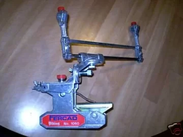

I picked up one to these file guides on eBay for about $20, very similar to the Granberg one.
I like it, works quite well. BTW Baileys had something similar on sale for $9.95
