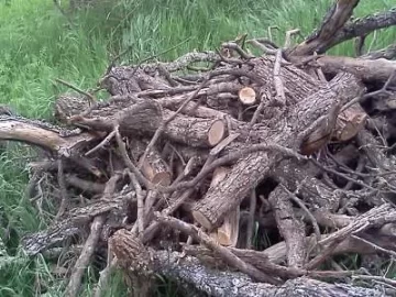

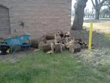

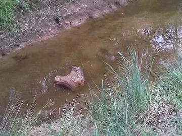

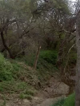

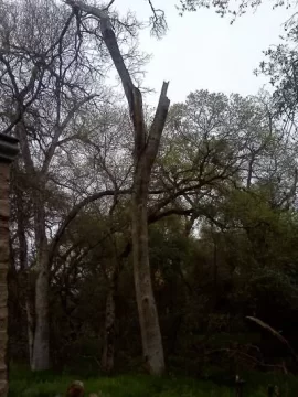

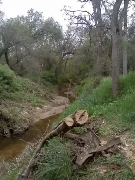

I'm in the Central Valley, 3 hour drive to the coast. The wind blows here too, gets very blustery in the spring and fall. The bark on these logs reminds me of old carpeting, always sand underneath. The logs appear to have been down several years. There are knot holes full of acorns, cracks full of sand, lots of bugs. It is along a sandy creek that overflows every winter rain, probably driving sand into the logs. Had better luck today, cut up a truckload of rounds. We only get a week or two of freeze every year, maybe explaining why this down wood is seasoned, or very close to seasoned. My winter is probably what a lot you east coast guys consider "shoulder season", but I still get chilly: These logs look and feel seasoned- Light weight, bark falling off, nice ring to 'em. No punk or rot. Also, that creek sand has .05 cents of gold in it for every 5 gallon bucket. You have to pick out fine flakes of gold dust with an eye dropper if you can find 'em. This was behind the sewer plant, I only had to wheel barrel it about 100 yards to where I could pull my truck up to it, I didn't have any permission either, it's not private land, a drainage area. I don't know if it's wrong, but I didn't have any trouble. The creek runs several miles through town. Pics- view of creek that I have scrounging in. Dead tree that todays logs came from. pile of 2"-4" branches with a seasoned ring. Stump of whats left of a fallen tree. Lost a round down the ravine, into the creek. Hauled the spoils to the pick up point, just shy of a full truckload.

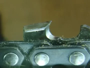

Sounds like the gulets are getting narrow. I would Like to see a close up of the chain. [Hearth.com] Chain Sharpening?
That explains it.

Chisel chain has a square corner on the outside. Semi chisel is rounded on the outside corner

In smokinj's pic you can see the side angle curvature ( the 'long point' is further forward than the gullet of the tooth,) although a pic from the other side of the tooth would show it better.
